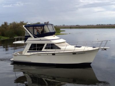

This is a 1989 Tollycraft Sport sedan. The place I can see to mount it is the radar arch, think it will be in the way.
If it were mine, I would buy the pole mount kit and put it on the arch with a pole similar as your GPS has been done. The GPS on the port side and the SCX20 on the Starboard side. Another location that would look nice would be outside right in front of the helm windows on the deck near where it ramps up to the windows, right dead center beam.
Thanks foe your input, I only have 2" from the Radar to the bottom of the shed. the GPS already hits and I have to put it down every time, Have already order a GPA-017 that is shorter. The forward location is a great idea.
