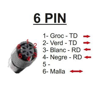

T tchikoali New member Oct 23, 2025 #3 Titanic II said: GP-39 ------------------------- CH500 Transceiver Unit (CH-503) CN1 (NMEA1) cable pn 000-154-054 WHITE wire TD-A ------------> YELLOW wire (RD-A) BLUE wire TD-B --------------> GREEN wire (RD-B) Click to expand... I don't have cable pn 000-154-054 6 pin port can you show me port 6pin schema where every pin td-a td-b pin located
