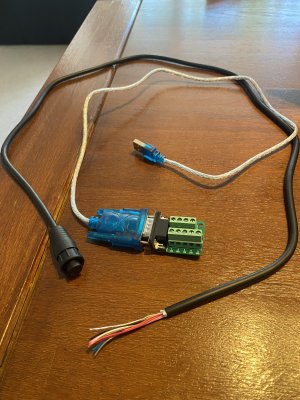

I just bought a GP 33 and want to interface it to my NEMA 183 devices. It appears the NEMA cable is no longer available. I was able to find a connector that fits, but need to know which pins are what so I can wire my own cable. I see there is an I/O diagram in the menu tree, but I haven't installed the unit yet to be able to get there.
Is there a pin out diagram for that connector?

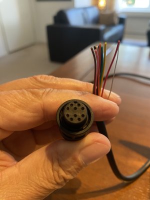

I had found that page. Looking at the connector on the back, how are the pins numbered?
Are they numbered like this? (Key way on top, looking at back of instrument)

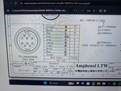

I would recommend following the color code of the wires (which shows pin numbers) on Page S-1 of the manual. Most connectors will also have tiny numbers on the connector when looking in the light at an angle but the color code is the best thing to follow when wiring it up.

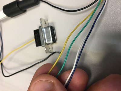

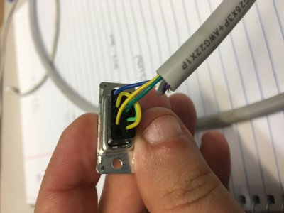

I've attached two examples... NMEA0183 using the RS422 standard of two wires for the talker (Blue/White/TD-H & TD-C) and two wires for the listener (Yellow/Green RD-H & RD-C).
The other example is how one would go about updating the GP33 via RS232 to Serial. If we're talking a true NMEA0183 connection, it'll be RS422 with two talkers wired to two listener wires (anything else is just RS232 and not certified NMEA0183 circa v.2 or higher).

The problem is that I don't have & can't find a 10-pin NEMA cable. It doesn't (or at least didn't) come with the unit. No one has them in stock. I found a connector that mates, and have some 9 conductor cable, so I can make a cable, but I need to know which pins on the connector are which in order to get the right color wires to the right pins.
I finally got something to work, but have no idea if I am using RS-232 or NEMA.
I did a round robin pairing of wires to a DB-9 connected to a COM port on a PC running Hyper terminal. Multiple combinations gave me data. One pairing that worked with my VHF did not work with my instrument system. I found a pairing that worked with both, but it would not drive them both at the same time. So I ran it through an Actisense NBF-2 and that feeds both listeners independently.
Success for now, but I would prefer to have the right color wires connected to the pins.

I think I have a solution for you. While the 10 pin cable for the GP33 on backorder; you could use a 10 pin cable from the FVC585, it is the same connection. If you order 000-156-405 (in stock), you will get a cable but need to cut off the fuses because they use the wiring for diffrent purposes. They also made a color change on a couple of the wires, but if you go this direction send me a PM and I can send you a color pinout compared to that of the GP33 data cable.

I did take a magnifying glass to the connectors and can see no numbers at all on them regarding the connector pins.
