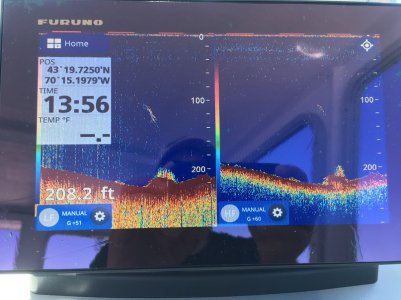

I had the 1971F connected to a B-164 for a couple of trips on my boat this past summer. I also was unsure about which transducer option to select but did end up using the 50/200kHz - 1kW option. The B-164 is a popular transducer. Having one more option in the list for 526TID-LTD/0-12-20 should not have been outside Furuno's capability. Frustrating.
Because I've been considering a TZT2-15" running Navionics, and connecting it to the same B-164 and hoping to take advantage of Rezboost, I'm curious to know if Rezboost was actually working in the 1971F when connected to the B-164 using the 50/200kHz - 1kW option. I'm hoping this may give me some idea whether or not Rezboost will work at all with the B-164.

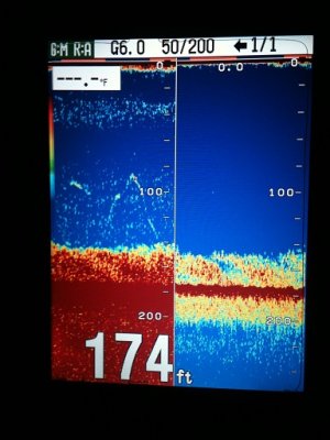

Below are a couple of screen shots comparing performance of the same B-164 connected to my old FCV585 and connected to the 1971F. I didn't see a lot of improvement with the 1971F.

Unimpressed with the fish finder quality and rather alarmed with the chart performance my 1971F didn't stay on the boat long.
