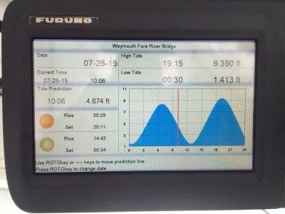

Question again about the tide chart when in 24hr mode for time. I have the setting in Menu set to 24 hr clock.
Today at 10:06am (1006H), when looking at tide chart for Weymouth MA Fore River, I am in 24 hr mode, high tide is shown as 1915, but LOW tide is displayed as "00:30" (which is 30 minutes after midnight in 24 hr time). Hopefully I can attach a pix of the screen.
Actual low tide should read 1230 vice 0030.
Why does low tide display in 12 hour clock when high tide is displayed in 24hr clock?
Timmy

My guess would be they only have the highest high tide and the lowest low tide for the day listed, not all four.
Spike

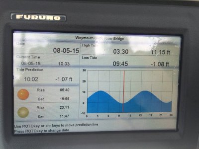

OK, here we go again with 24 HR clock and tide charts.
I cannot understand Furuno's logic as to displaying tide charts and number readout of high and low tides. The unit is set to 24 hr and when using the unit today, both high and low tides displayed tides that had past, ie; the upcoming high tide less then 6 hours in the future was not indicated, only the past high and low tide.
Since low and high tide are VERY important and Furuno unit's tide numerical readouts cannot be trusted, I will have to use my smart phone for tide charts.
BE AWARE of the numerical displays of high and low tides for they may not be displaying the correct CURRENT and UPCOMING tides......................
Dismayed......
Timmy
