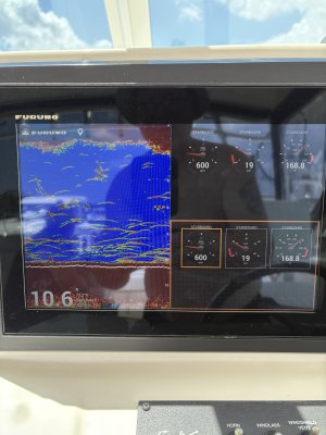

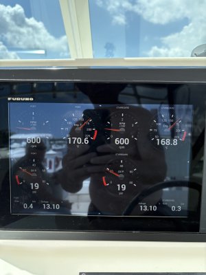

I’m trying to show port and starboard engines along with bottom sonar . 3 screens on 1 page , issue is either it’s only port or starboard engine data along with bottom , I need both engine data and bottom sonor , the gauge only display shows both engines. How do I fix this IMG_0426.jpegIMG_0427.jpeg
Touch one of the two quarter screens and choose twin engines or choose edit page and make it look however you want.
I tried all of that ,actually when I changed starboard to port or vice a versa , both screens data changed to the same data
I just verified that too. You'll only be able to set twin engines page in one of the quarter pages and then edit to show the information for each engine within that one quarter area. The other quarter could be configured for either some other info or display page.
So your saying I can put the data from both engines in only one quarter?
Yes. It appears that's the only way to see both. As you noted, if you try to change one quarter, it changes the other...so, that won't do what you want it to.
So I need to add port or starboard to one of those quarters then have @ blank quarter to do what I like to
Select one of the quarters where you want engine data to be shown (yellow box appears around that quarter). Then, touch the quarter and a menu should appear where you can choose twin engines. Once that is selected, both engine's information should appear in that quarter. Select the other quarter and touch it to bring up the menu and select some other data that is useful for you OR go to the Home screen and touch and hold the display page that shows the sounder and two instrument pages so that the Edit button appears and then select chart plotter, radar, or some other page to replace the quarter screen that doesn't contain your engine data.
