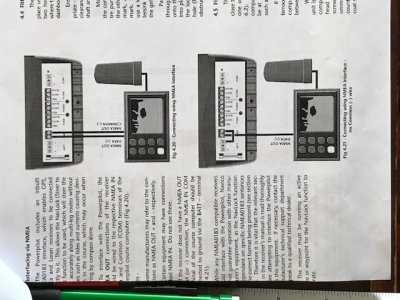

Currently I have a Furuno Gp 1870 and I want to integrate it with a older Navico power pilot Hydraulic ph500 is that possible. I have attached the owners manual diagram of the Nmea0183 connection
I understand that it uses a older interface Nmea0183 and the newer furuno unit uses the can bus network. I need to buy the converter IR-Nmea2k2 converter what else do I need to need to completing the installation. What wiring colors will I need to connect to the Navico junction box
Can bus cabling, does it need a external power supply. Thanks hoping I can get it to work. Merry Xmas

Sorry, apparently that file had a web site problem.
It has been updated and should show on our website within about 24 hours.
To get the document, go to our website (www.FurunoUSA.com) then search for the product (GP1870F). Once you bring up the product page, you should see the sample drawings under the "Technical info" under interfacing.
Good morning Johnny
When I do the search for the Gp1870 f under technical info I just see
the gp1870 wireless guide and the other other is waypoints. What am I doing wrong Thanks
