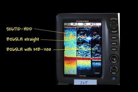

The FCV-585/587/588 were not designed to use Chirp transducers. I tried this test years ago just to see what would happen with a B-265. The B-265 has the same LF make up of the 175L. It was during this test we found that the LF elements work best at 42Khz, not 50Khz. There is also an impedance mis-match when connected directly and when using the MB-1100 matching box. The below picture is a LF comparsion showing the 526 against the 265/175. During this test I was using a Medium TVG.

Thanks Snips,
Is there a way to set the LF on the machine to push 42 instead of 50?

Glad to hear that you have the 264's instead of the 175's.
My first question would be since these are tilted elements transducers how close they are to being pointed straight down? Very few hulls have exactly 12 or 20 degree dead rise, in shallower waters this isn't a big deal but in deeper waters it can be. The TVG control on the 587 is different than the 295. On the 295 you could control the sounders gain in different parts of the water, on the 587 it control the entire water column. If you are trying to get a good view of the bottom without looking at the whole water may I suggest using the Marker Zoom or Bottom Zoom modes.
