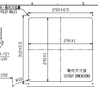

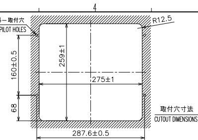

Kraken Moderator Staff member Jul 8, 2025 #2 Here are the cutout dimensions for the 1945: Here are the cutout dimensions for the FR10: The FR10 is slightly larger.
