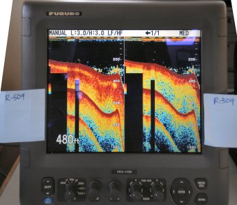

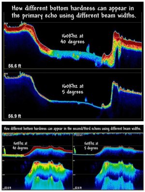

Hard to say for sure, but I am confident that either transducer will work for you. I have attached a couple of screen shots that may help you decide. The first is a FCV-295 using two different 1kw 200Khz transducers in 70m. The LF side was using a 12 degree and the HF side (right) a 25 degree. The second attachment is beam width vs. bottom hardness.

SO as I Understood the Wider cone will give better results with more rebust colors.That could be due to side lobes

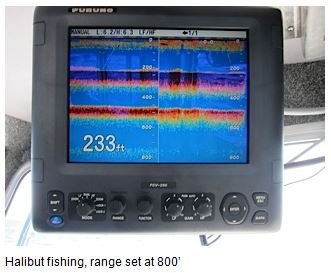

Again it is hard to say a depth range. However the below screen shot is showing two different transducers at 38Khz at a 1kw power setting.
