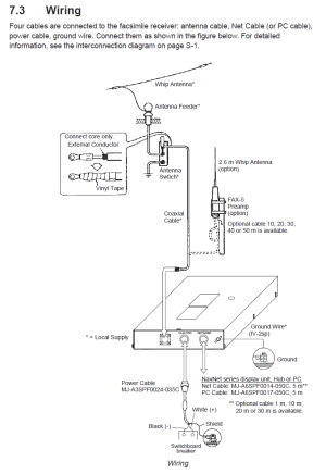

Hi I have purchased a fax 30 unit and wish to connect it to a computer but it has come with no cables. Anyone know where and how to connect it to a computer. Brian
Here is the part number for the power cable: 000-157-943-10
Here is the part number for the LAN cable to connect to RJ45 network jack: 000-159-705 NavNet to PC Cable RJ45->6 Pin
For the antenna you can use a long wire or 8 foot whip with the FAX-5 coupler (amplified),
