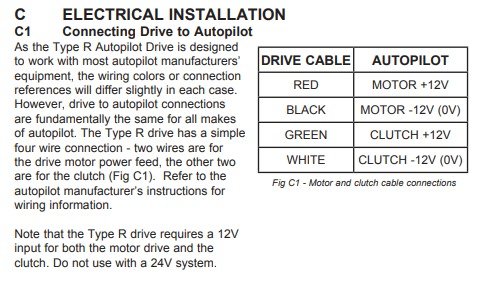

I have an octopus pump type S. It has 4 wires. I believe red, black, green, and yellow. TB2 where they are going to only have 3 slots to wire it.
Normally reversible pumps will have two wires. We don't sell any four wires pumps. Do you have a wiring diagram or any ideal what the wires are?
So I got an opportunity to talk this over with the autopilot master. In principle it should work, but let's take a look: :shock: :wink7
Two of these wires are reversible pump wires, and the other wires are for a clutch. So in principle our best guess would be to wire the motor to motor and clutch to clutch. Yet, with that being said, it's unclear how the pilot would behave or whether or not it would actuate correctly. So the better idea might be to wire an independent switch to the clutch wires. Though, while that would be more reliable (because our pilot would drive like a normal reversible 12v) you as the captain would have to remember which mode the clutch was thrown in. You could get a lit-up led switch which was on when it was on, and off when it was off.
That's at least my thinking about the product, :sail
