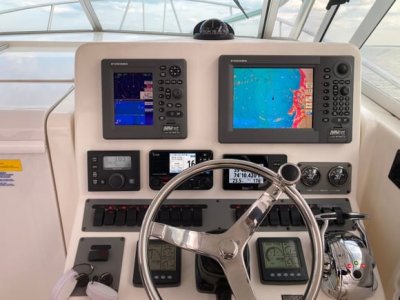

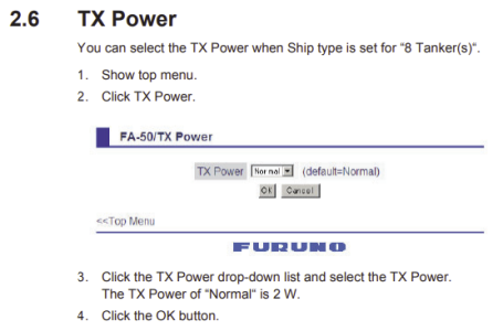

Hi, is it possible to increase the power output? I have a 8' ais antenna on my hardtop, base of the antenna is 10' off the water and 9' away from my vhf antenna. Gets about 5 miles out. Would a liner amplifier work to boost it to 5w or is there a software change that can be made? I know in tanker mode it goes to 5w but all the others are 2w. Boat has navnet2 and would like to keep it as such. 7" and 10" display, 3.5 open aray, bbwx2 and gp39.
