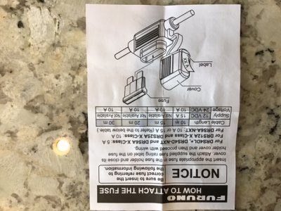

I have a new DRS4D-NXT. I will install with a 15 meter power and lan cable. When I look at the attached instructions that came with the cable, it suggests a 5 amp fuse for the DRS4D-NXT. I want to use a breaker with the radar and have it on a 12 volt system. Referring to the attached directions, it suggests a supply of 15 amps for 12 volt and a 10m cable, but not available for the 15m cable.
What size breaker should I use, and can I use the 15m cable?
