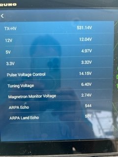

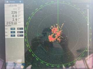

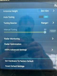

First trip of the year and I barely have any signal strength? Not sure why or where to start looking.
I did factory reset. and I did manual gain to 100% with no better results.
I am using with a TZT2BB and am planning on the update installation this week.
Any advise?
Ensure your rain filter is all the way to zero and the clutter is all the way to zero as you attempt to manually run the gain up.

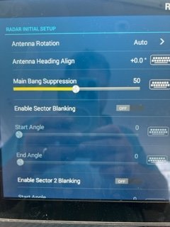

Doesn't look right, see pics:

The mainbang suppression being set to 50 is quite high but not your problem. If this is truly a DRS25A it has been around awhile and it might be time for a new magnetron. When was the last time a magnetron was replaced in this radar?
