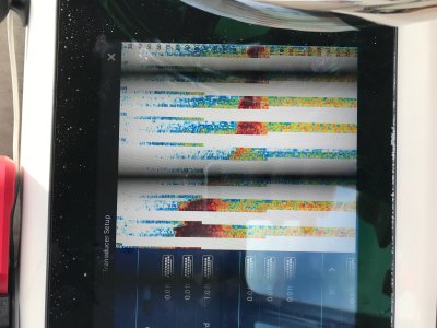

Wondering if anyone else is having problems with their DFF3D reading depths greater than 600'. I am a deep drop fisherman and fish ranges from 600-1000'. I was told that it would read as deep as 1200'. I was so ecstatic to purchase the DFF3D with my TZT2 12" MFD with very high hopes. I have used it three times thus far and it works in depths below 300' but when I head to my fishing grounds, it is unable to read the bottom. I have tried the sonar mode, side scan mode, 3d mode and none of them read the bottom at the depths that I fish. I have messed with every conceivable setting on the unit to no avail. Spoke to a Steve (very nice) at technical support who suggested that this might be a problem with grounding wires, but when I inspected the wires, there was nothing wrong with any of the wires. Read the manual inside and out. Ducer is placed in proper position. IMG_1541.JPG
This is what I see at the 600' range.
Frustrated and wondering if I wasted a significant amount of money on a product that so far, has not lived up to the hype, or if there is a fix for this. Any help would be greatly appreciated!

Good afternoon Brookes,
Thank you for your inquiry. We also appreciate the photo that you supplied, based on what i could see it appears you either have a tremendous amount of turbulence going over the transducer face that could account for the gaps in the photo that you provided where the bottom is missing. If you are confident that the transducer is working in clean water then it appears the DFF3D is having a hard time locking on to the correct bottom signal and it could be cycling to deeper depths if you are running the sounder view in Auto Range. If the sounder is cycling between depths it is because it does not think it is getting a good bottom signal which could be due to noise in the system. I know you mentioned that the transducer has a solid ground and that the DFF3D box has a solid ground but I cannot tell based on the photo that you are experiencing noise in the system. The photo that you provided when it shows the bottom does appear to be heavily affected by noise or you have the sensitivity really cranked up.

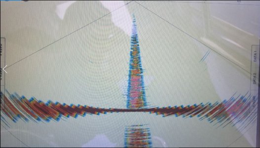

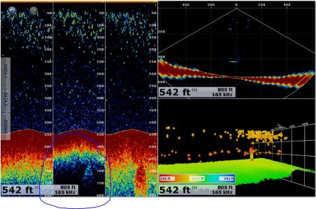

I know we would appreciate another photo of the sonar view like the photo below.
As you can see in this photo that is a sector which is showing quite a bit of noise. If you can provide a photo of this view and range this view out to see below the bottom it would really try to help us what is going on.
I suspect the ground points that you are using could be noisy, or there is something else on the boat causing the sounder to lock on to not lock onto the bottom profile. Either way based on the photo that you are showing it appears that noise is the culprit?
Please see the photo below, the circle that i made in blue shows a nice bottom tail but it does not continue to carry on, it cleans up after a while. In the photo that you provided the space below the bottom where the bottom tail is continues on for quite a while and is really messy. My guess is if you where to range out even further in the photo and provided it would really never clean up, that is caused by noise.
You could try to play with the bottom level detection, the default is "0." I would try to move this down to a "-20" to see if the sounder can stay locked on the bottom. The other option would be to try an isolated power supply or even another spare battery to completely isolate the sounder when you get to deeper water. If you do this i would kill everything on the boat except the TZT2 and the DFF3D, engine off, inverter off, ect. and start to turn things on to see if you can see where the noise is coming from.

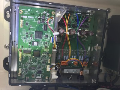

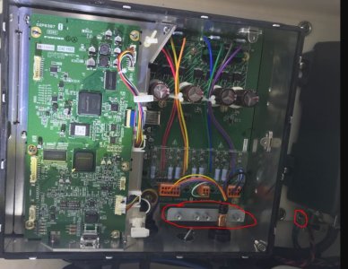

Thank you so much for the information. I have a thu hull ducer with a high speed faring block, so I do not believe turbulence is the issue. It must be noise or interference. The DFF3D is mounting adjacent to the FAP-7011 and the ground wire is shared with this unit. Could this be causing noise? Might be a stupid question, but is there a way to test the ducer while out of water?

When you say the ground wire is shared with the Furuno Pilot, what is the source of ground for these systems?
If you take a look at the bottom right of the picture (poor lighting), the ground wire from the DFF and the FAP-7011 are both grounded to what looks to be the mounting bracket for the FAP-7011
Thank you for your photo.
I see what you mean by the green wire. That is to earth ground, do you know where on the vessel the earth ground is located? Is it to a grounding plate that has contact with the water? Is it to the engine block ETC?
I also see that in the photo the transducer wire is not being clamped. Based see that it has some appears to have been clamped in the past, did you remove the transducer clamp only for the photo? Is the transducer clamp usually in place?
It would be good to try and get some photos why you are out next, try shutting everything down other than the TZT2 and the DFF3D. All other breakers off, engine off, inverter off ECT. To see if that alleviates the noise. If it does not try taking the earth ground off to see if you see an improvement?

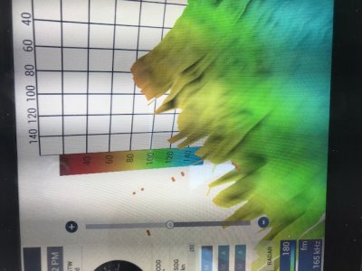

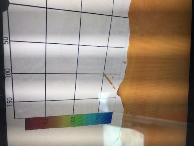

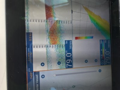

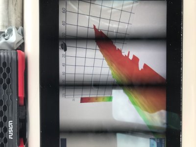

Here are some pictures from my last trip.
IMG_1564.JPGView attachment 2View attachment 2Hi C-Bass.
I was able to mark as far down as 150 fathoms (900ft) and able to see some fish as well. When I am in the triple beam mode, it seems like the image on the right has the strongest signal and the middle and left are rather weak. Also, looking at the 3d mode, I am able to capture more grounds on the port side of the boat, but the SB side doesn't pick up to much ground laterally.
As for equipment, I have a Defiance Admiral 22' EX with twin Honda 100 outboards on an engine bracket. My system is a complete Furuno package with a TZT2 12 ", DFF-3d, Autopilot 711c and a DRS4D-NXT radar. Let me know if you need any more information. Tnx!

Good morning Brookes,
As you can imagine it can be hard to recommend settings without actually being on your vessel on any particular day. As ocean conditions change, sea state changes, turbulence, and other dynamic layers such as plankton, thermocline, pycnocline, ETC. changes to your sounder settings will need to be adjusted.
To start with you could try experimenting with some of these settings.
1.) TVG: Make sure the TVG distance is set to a depth that you are actually fishing in. The default value is 1000m. Which means if you have not changed the TVG value and you are fishing in 1000ft of water you will not be getting the full sensativity of sounder. So I would set this value to say 1000ft if that is the depth you are fishing in. There is also another TVG value, the default value is 5. I cannot remember if this sounder follows the "less is more" saying. Meaning, the lower the TVG value, the more stuff you will see on the screen. So once you have the TVG distance set, if you are still not seeing enough on the screen try lowering or raising the other TVG value (not distance) to increase the sensitivity. You should see more information on the screen depending on what way you move this variable.
2.) When looking for fish deep on the triple beam sounder, as you get deeper the outer beams will lose sensitivity. So we believe it is a good idea to narrow up the beams to 20 degree angles and set the beam width to 20 degrees as well.
3.) If you have not adjusted the speed of sound setting found in the Multi-beam sonar menu this may need to be adjusted. Make sure the system is set for salt water, the speed of sound is an important factor for multibeam systems. If the speed of sound is not set properly it will make the bottom look either convex or concave depending on the value if it is higher or lower. You could try using the automatic sound speed adjustment, info on that can be found in the DFF3D manual. Or you could manually adjust it by setting the speed of sound adjustment on a known flat piece of bottom, then use the cross section view to make sure the bottom line is flat, not convex or concave.
4.) For the 3D history display if you are trying to target fish right off the bottom you could try adjusting the Seabed Echo Calibration. The higher this value will allow the fish to differentiate themselves from the bottom.
