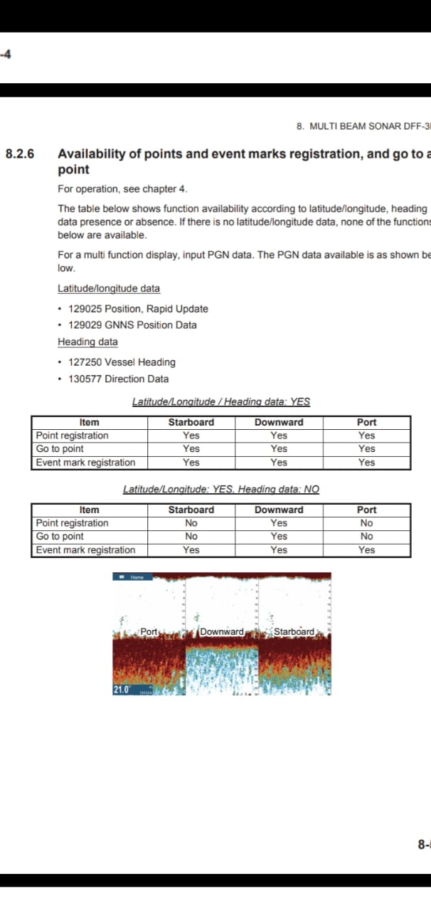

According to the manual marking of waypoints in side views is only possible with Heading Data (SATELLITE COMPASS) information. Can this information come from third party equipment connected to NMEA200 NETWORK or must it be Furuno (eg SC33)?
Regards
Angelo
Mamasso,
To my knowledge any source of heading will work.
Snips":3gsiwbbt said:
Mamasso,

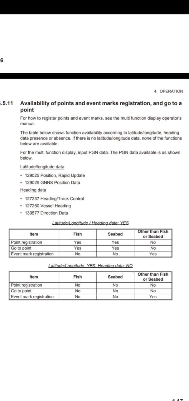

Why is it stated in the DFF3D manual that 2 Heading PGN's (127250 and 130577) are required and in the TZT2 manual it informs 3 (127237,127250 and 130577)?
Which ones are really needed?
Regards
Angelo
Mamasso,
The PGN's listed contain the information needed, meaning you have three options for heading data. The most common PGN for heading is 127250 which is available from a Flux gate or satellite compass.
