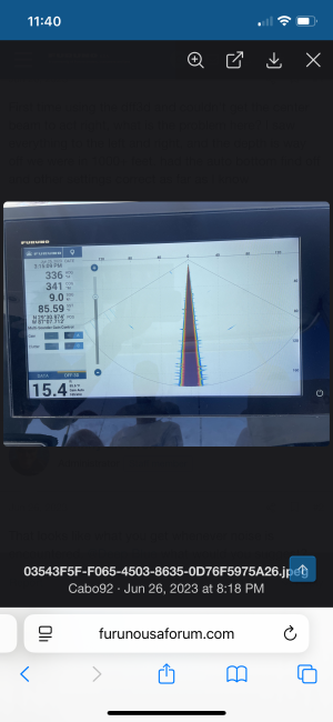

It may be interference as noted. However, I have seen this routinely when there is seaweed or a big school of small baitfish under the boat. There is a "Fish Detection Level" setting in the multibeam sounder menu. Do you have it set to high? Try a lower setting if so and you should not see as many red dots for fish schools.Has anybody experienced and issue where the DFF3D in history mode and Cross section shows a lot of fish ( I think it's interference) down the middle of screen? Is it a setting I'm missing or faulty equipment.
Thanks, I've adjusted the fish detection levels. It does remove some dots, there are always way more dots in the middle, even when there's nothing under the boat.It may be interference as noted. However, I have seen this routinely when there is seaweed or a big school of small baitfish under the boat. There is a "Fish Detection Level" setting in the multibeam sounder menu. Do you have it set to high? Try a lower setting if so and you should not see as many red dots for fish schools.
Have you tried setting the gain manually and reducing it? Is it possible there is something on your hull in front of the DFF-3D transducer that is creating turbulence?Thanks, I've adjusted the fish detection levels. It does remove some dots, there are always way more dots in the middle, even when there's nothing under the boat.

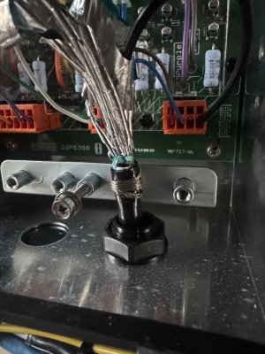

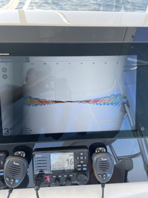

Ok good deal I'm sure that's my problem. My installer is a Garmin guy so really didn't know what was going on. I'll get to the boat this week and try to fix using those instructionsI had a very similar picture as you're getting. When looking at history mode, it would show a lot of dots down the middle constantly.
The process was really easy, make sure you have the manual to ensure the transducer is reconnected correctly. I had the conductive copper on it, but I had electric tape over it. I had also trimmed the conductive foil off the individual wires. The conductive copper needs to be in contact with the metal ground plate. I'm thinking that was my mistakes.
