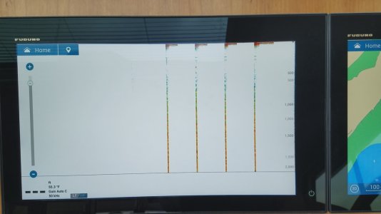

On a recent trip, my depth display froze at an impossible value (1500' in charted 600'). Powering everything off for a few minutes didn't fix it. My destination was in ~10' (depending on tide), so I was concerned. Powering everything off overnight fixed it, but it froze again on the return trip after ~1hr.
Speed-through-water and sea-temp continued to update but depth (and the fish-finder display) was frozen. The LED on the BBDS1 blinked green about every 2 seconds. I pulled power from the BBDS1 (but not the TZT19Fs) for 10sec, but that did not fix it.
I rebooted both TZT19Fs (but not the BBDS1) and it started working again, although it failed ~1hr later.
