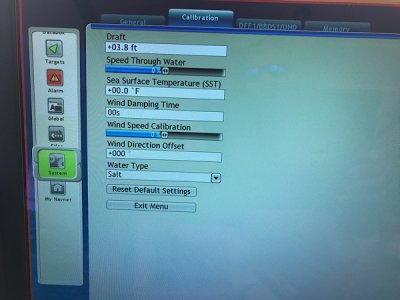

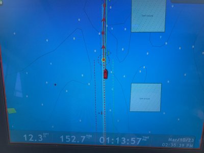

I’m using Navnet3D and yesterday I set a minimum depth alarm of 9 feet. i have a 3.8 foot transducer offset. My NN3D was showing 12 feet actual depth but the depth alarm was going off. The only thing I can figure is the depth alarm does not factor in the offset, is that correct?
if so in this example I’ll need to set my depth alarm for 5.2 ft (9 ft minus 3.8ft), is my thinking correct?
