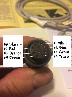

I see in the wiring diagram that there are numbers for each wire on the plug. How do those numbers correspond to the plug itself so I can check continuity ? Sorry if this is silly simple question but I am a simple mechanical engineer....

Fluenta,
Hopefully this will help.
