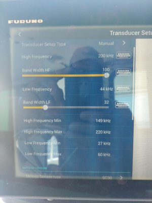

New to me boat and to Furuno. I did a Software update and lost my transducer setting. I have an Airmar CM599LHW. I tried to Manually set up in transducer in set up type and that did not work. When I picked 200Khz:50/200-1T from the model list it is working.
Am I getting the most out of this Transducer by leaving it on this setting or is the a better one to choose? Did i do the Manual setting wrong? Picture attached. Thanks
