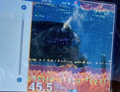

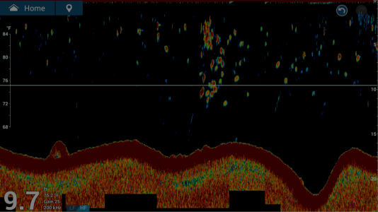

Just to give you guys an update because no one got back to me.
I made a quick connect plug for testing purposes to go from simrad to furuno. It worked very well i was able to go from one machine to the other without any unwiring of the transducer. the b148-12 works fine at 50\200, Temperature also reading good. the 148-12 is set to b60 on furuno tzt3 .If you guys have any detailed questions PM me. ;)
couple of screen shots one of bait balls and one of my bait off bottom.
Jsubzero,
Looks pretty good in shallow water, :jump How is the performance in deeper water..? :think

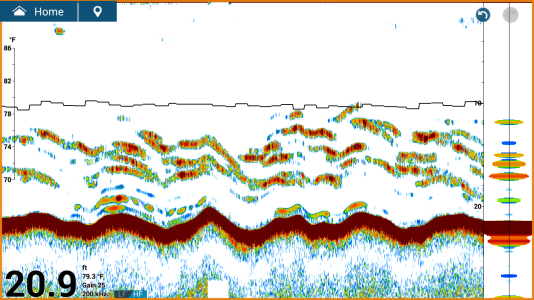

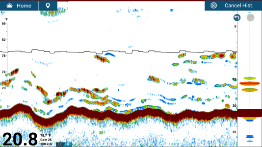

more screen shots fishing for mackerel. set a low gain still great results! got to love furuno!
