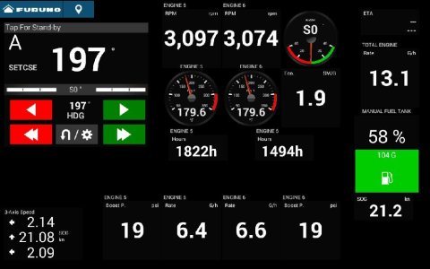

I have built a custom engine gauge display page. One of the data box choices that I selected is "average fuel economy." Although the real-time live combined fuel economy works fine, the average one stays blank. A related question is that the "average fuel economy" option for a data box in the sidebar is not available to select even though it is available for the gauge page. That seems odd.

I don't understand why that would be the case. If the correct starting value is entered in manual fuel management and you update as fuel is added, it is far more accurate than relying on an imprecise tank sensor because it is using the fuel consumption from the engine ECU to calculate remaining fuel. So today for example I started out with 300 gallons and used 84 per my engine gauges and the manual fuel management tank level showed 216 gallons remaining in the tanks. My tank readings from the sensors are not nearly as precise.
