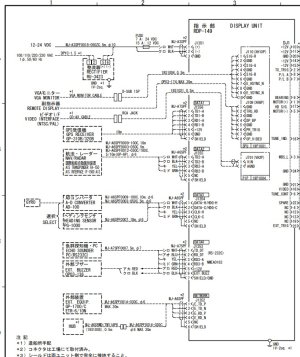

Yes both offer 0183 output that can be wired to the Vx2 as long as the port is open. (data1 of 7" vx2 or port 2 of Vx2)
See attached (Fr. 1834C/NT)
