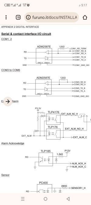

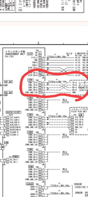

When installing the AIS FA-170 device with the radar device, pins were installed in the COM1 port and only four pins were connected, and the fifth pin, which is the ground, was not installed. When the technician was asked, he said there was no need, noting that according to the catalog, it must be connected.
