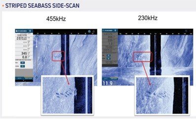

Anyone have screenshots of actual fish with the 455kHz sidescan? It seems like Hummingbird is what most people are using the in Chesapeake to find fish with sidescan. I currently have the 220kHz and its excellent at finding structure.

Please note that with networked TZTXL system, it only supports one Side-scan frequency at a time—either 230kHz or 455kHz, but not both simultaneously. There is also the risk of the second harmonic of the 230kHz frequency interfering with the 455kHz frequency.
I've included an image to illustrate the differences in fish target appearances between the two Side-scan frequencies of 230kHz and 455kHz.
I hope this information is helpful..?

Very helpful! So what happens if I have both sidescan transducer installed? Do I have the option of what frequency in the sidescan menu? Or do I have to unplug the frequency that I am not using? That 455kHz sealed the deal for me. I’m going to get one of those too.
