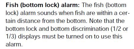

Using the Bottom Lock Fish Alarm (I feel) is the best option because you only need to set it up once. If you would like to see the tail of the bottom try using one of the two Bottom Discrimination modes. 16ft is the smallest zoom setting.
