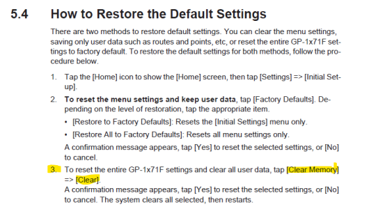

Back up all your points and routes and do a memory clear on the GP1971f. After the memory clear the first time you turn it on you can pick NAVIONICS as the charts and it will boot into that mode.
While it shouldn't hurt it, it is always a good idea to remove the chip before starting the clearing process.
NEVER remove or install a chart or memory when the unit is turned ON, always turn the unit off first.
