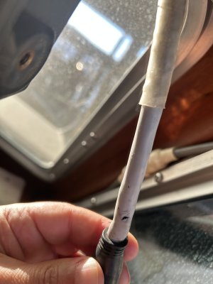

not sure why I didn’t try fiddling with the antenna cable originally but I did tonight. After loosening it up a bit near the display connection and bending back and forth a bit the unit started operating correctly. Right near the connector covered by a clear sleeve I noticed two nicks in the wire. Haven’t opened it up yet and Doesn’t look like much but guessing one of the wires is barely connected. Any tips on repairing one of these wires inside ? Solder or solder-less conector?

Best type of connection is solder with shrink sleeve over it. It also can be done with a simple waterproof junction box too.
