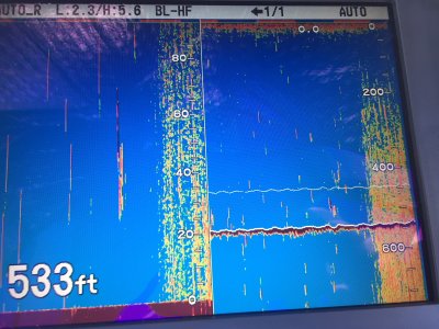

was bobbing up and down here and found the thin slither marked in deep red, then we decided to move to another spot, the interference filled the screen as I had the gain up high.
question is, I'm guessing turbulence ? (tm265)
if so why isnt the top part of screen filled with scatter?
can i change a setting to stop it filling the screen because if i turn gain back then i dont spot any fish targets

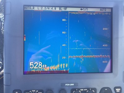

we did alright here found something but couldn't get a bite

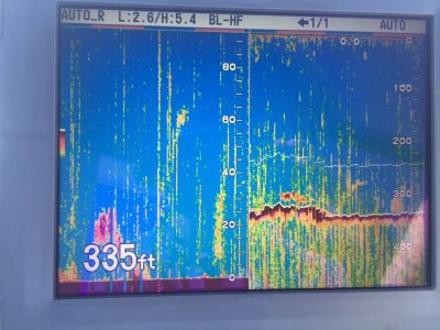

trolling for tuna here around 6 knots
on the HF there are plenty of deep red lines up and down
on the LF no deep red lines
any ideas for what they are ?

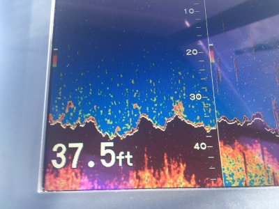

I'm guessing the main target (RHS of sounding) of 110 ft high was a kelp forest

Empire07,
Thanks for the screen shots. One suggestion would be to try changing your IR setting (Interference Rejection) from Auto to Medium.
