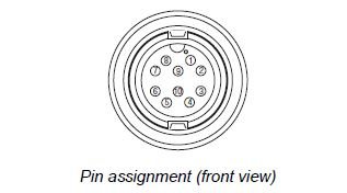

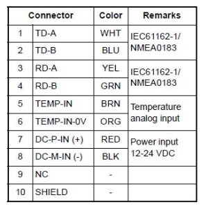

Please see the photo below that shows the front view of the power connector and the pin out. If it is the power connection that has broken pins, the pins may not be affecting power to the unit, depending on what pins are broken you might be ok.

That said i agree with Johnny, if the unit is powering itself off then there is something wrong with power to the unit. Either a bad cable, connection to main breaker, fuse, or the internal power connection on the board.
We need to try and isolate the source.
