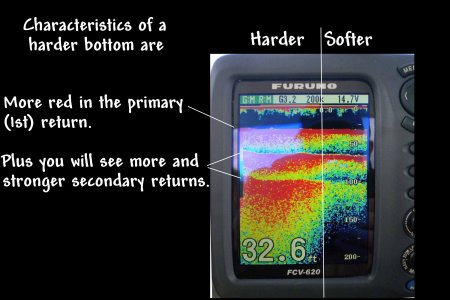

Dangerussneck,
The easiest setting change is using a deeper range and look at the strength of the second and third returns.
