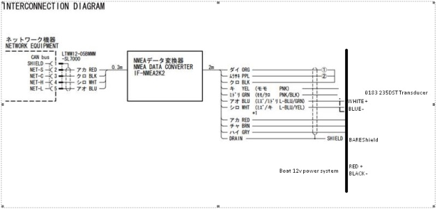

Is it possible to connect this transducer to a tz2 touch or FI-70 display for water temp and digital depth? How to convert from 7 pin to 10 pin or ?

You are able to do this with the IF-NMEA2K2 NMEA converter.
You will need to cut off the 7-pin plug to expose the wires. You will use the White, Blue, Red, Black and Shield wires. The diagram attached should provide you with enough information.
It is recommended to use on board 12V power for the 235.
