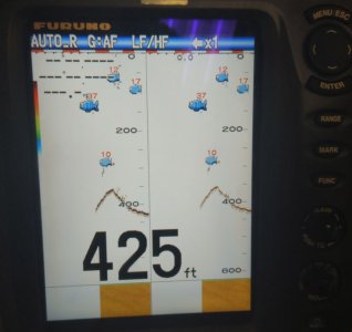

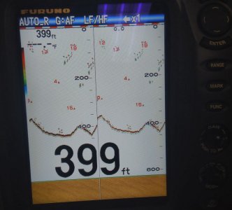

We have tested it, it works. The photos I posted were exactly that. One with accufish icons and one without the icons but both with accufish on and with BD and enhanced rezboost. I don't know what to tell you.
