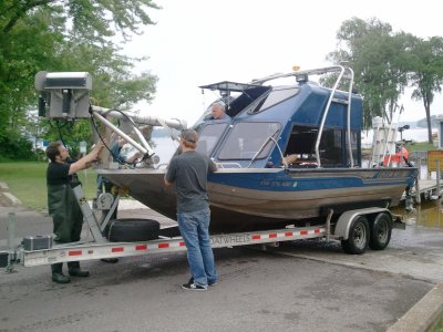

I am confused by what you mean by "The transducer will be holded on transom in the bow of the ship"
Do you have a picture that shows how the current transducer is mounted?
Like on the picture, but the vessel is little bigger.

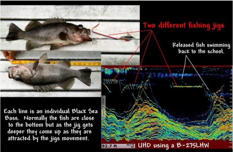

Oetgreen,

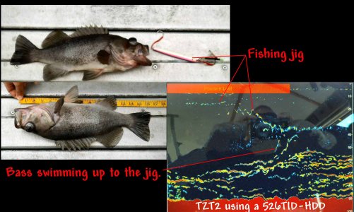

The FCV-295 paired with a B-275 is a nice combination. The advantage that the B-275 has over the B-260 is that the HF side has a much wider beam angle, better for looking at mid water fish down to 40fm. I don't have any direct comparison screen shots but maybe the ones below might help. The DFF1-UHD was using a B-275 and the TZT2 was using a B-260. The main advantage the UHD will have over the FCV-295 is being able to better separate targets vertically.

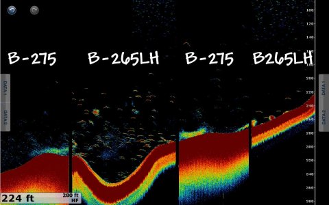

One more question:
Which transducer with UHD will be better for bottom fishing on 200ft - B265 with narrow beam on HF, or B275
Thanks!
Oetgreen,
Here is what the HF side will look like at the same gain setting.

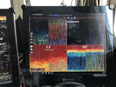

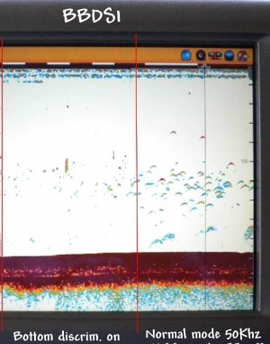

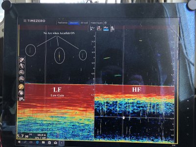

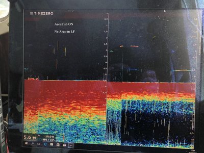

Hello Snips.

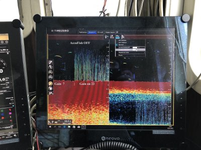

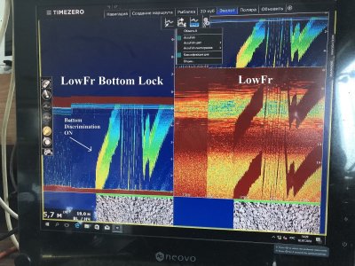

Finally I have bought and installed DFF1-UHD and B265.
After connecting everything and turning on I have some problems.
1. When turning AccuFish ON, sounder begin making noise like a silent clicks. A lot of noise appers on LF Screen. There are no arcs, only stripes on screen.
2. When turning Bottom Discrimination ON obtaining that is on screen below.
The ship is at the pier in the river.
Transducer B256LH is fully immersed under water on depth of 1m. (Attached to a metall pipe)
No ground connected to dff1-uhd.
Ostgreen,
When you use either the AF and BD modes it will change how your fish targets will look. Something can watch for yourself is by going full screen 50Khz with both the AF or BD modes off, stay full screen 50Khz and then turn on the BD mode. As you can see in the screen shot below the difference it will make on the water column targets. As far as the noise goes, UHD is really sensitive to external noise sources. Grounding is very important and we have found in some cases that shields from the LF and HF transducers need to be attached to the metal cable clamp instead of pins 3 & 6 in the orange WAGO connector.
