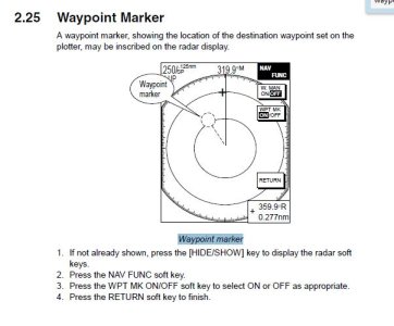

Thank you for your inquiry. Couple of questions, do you know what NMEA0183 data sentences the Garmin 5212 is outputting to the Furuno 1943? The Furuno will likely require "RMB", "WPL" in order for the Waypoint Lollipop to display correctly. The Waypoint Lollipop will only be displayed on the Radar Display, and the feature must be turned on once the correct data is confirmed on the 1943. To turn on the Waypoint Lollipop refer to the photo below.
Please confirm what data sentences the Garmin 5212 is outputting. From there we can check the receive ports to verify the data is being sent.
