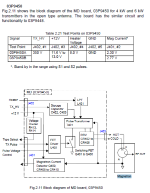

Deep Blue Moderator Staff member Apr 6, 2018 #2 kklix, Here is a diagram on the test points used for checking the Magnetron and Heater Voltage on a RSB118-092 Gearbox. Hope this helps..? Deep Blue -

Deep Blue Moderator Staff member Apr 9, 2018 #4 kklix, The voltage on the magnetron doesn't change, (it should be around 7.1 vdc) so it really matter what range scale you use to check it. - Deep Blue
