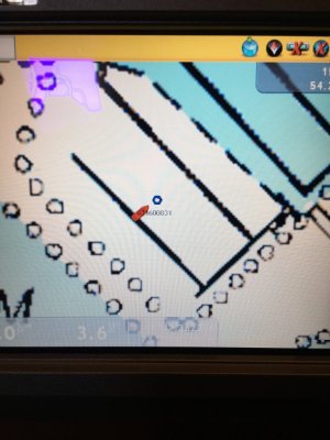

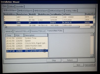

I have connected a DSC radio to the NMEA2000 network via a Furuno IF-NMEA2k2 converter. Does anyone know if this will work? When the radio receives a position report nothing appears on the NN3D MFD. (It works when the radio is connected to an NMEA0183 port on the MFD). I ran the installation wizard to look at the incoming NMEA2000 data and the MFD seems to recognise PGN 129808. It doesn't show any data in PGN 129808 though???
NN3D version is 2.11
IF-NMEA2K2 version is 1.4
