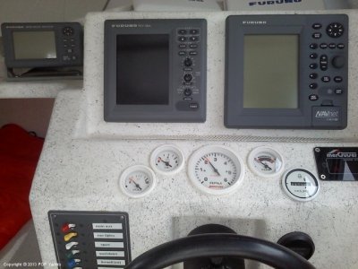

All my old waypoints have been loaded into my Inavx software but I can only export these files in GPX or CSV format. Will The TZT2 accept waypoints and routes in GPX or CSV or do I need to somehow convert these to Furunos Tzd format? Heres a photo of my helm before going in for the upgrade and I've got just enough room for the TZT2 12" and one FI-70 and some extra space to spare
