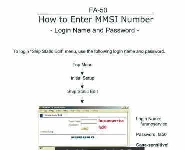

Hello. I am new to Furuno and new to the forum. Just bought a new to me vessel with Navnet3D and FA-50. The mmsi is the same but I want to change the vessel name on ais. Asks me for a user name and password. Where do I get this?
Tony
Furunoservice. Does not fit in the login name field. It was pre-populated with “service”. Password “fa50” does not work. Any other ideas?
My guess is you are trying to get into the service area that has a different password for only authorized dealers. (don't do that)
If you are trying to get into the user area to change your MMSI and boat name, the password should work. If not then someone might have changed it and the unit might need to be factory reset, so you can start over.
