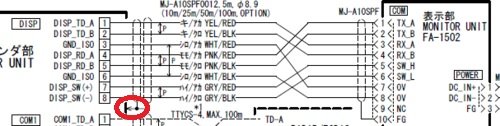

The MKD error is when the processor unit is not seeing the display unit, and it would cause the data entered to not be saved.
I would verify that the wire is correct, and make sure each wire is making good contact.
I have attached the wiring diagram.

I already have checked the wiring 2 times.
Will check again.

Do you have the wire shield grounded to the case as shown?
If you didn't ground the shield, it might explain your problem. This is VERY important. If that isn't it; you will need to have the unit checked out by your local dealer/distributor.
I verified that the shield is firmly seated in the fastening rail inside the transponder.
Both transponder and display grounding wires are also connected to the same bus bar.
