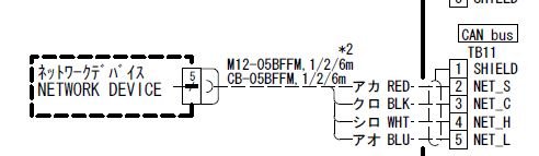

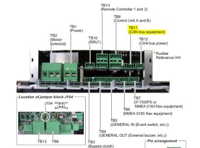

Yes the FAP7002 also needs to be connected to the N2K backbone. Once that is done it should be able to see all the data available that is on the backbone. You are right about cutting off the connector on one end of the cable. Please make sure you double check what connector gets cut depending on how you have the backbone "T's" setup.
The location on the FAP7002 to connection to N2K is TB11. See photo below.
The wire color pin out is below.
