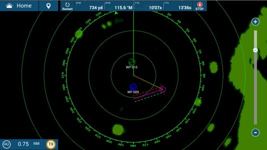

Thank you for the fast response. I own the TZT2. When I downloaded the Operator’s Manual for the TZT3, section 6.17 How to Show, Hide or Cancel an Active Route has the picture below.
This is exactly how my TZT2 display looks with numbered circles for points, and these points block the radar targets. Your image above is very different, and seems to correct the problem. Is this something that was only improved in TZT3, or is there something in the TZT2 setup that I am missing?
I am moving your post from TZT3 topic area to TZT2 to save the confusion created. We have new software coming out for TZT2 that makes many changes, I will have to check on this one.
So playing with the TZT2 v7 beta, it is like the TZT3. The active waypoint (goto) will be where you can see through it. If you use the full route the first point nearest you is also viewable but the other spots of the route are solid but the spots are kept very small so it covers little. The active waypoint was addressed by someone else about a year ago and it looks like they addressed that concern with the newer TZT3 and the upcoming v7 software for TZT2. Ultimately the feature can be turned off if found to be disturbing to the operator. I like what they did with the newer software.

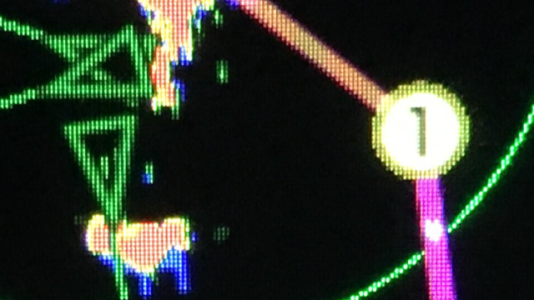

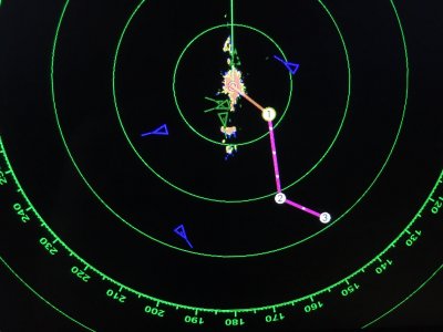

Hi Johnny, I decided to upgrade to the TZTouch3. It’s a beautiful instrument, and I really like the Control Keys and RotoKey. Unfortunately, I am still having problems with hidden targets. The active waypoint when using “goto” is see-through, and seems to work really well. However, when using a full route the first point is large and hides targets (see screenshot).
Is there something in Setup I am missing, or is it possible the v1.07 software I am running is not up to date?
No it is up to date. When I looked at TZT3 the normal waypoint lollipop for goto is transparent. When I tried the full route like yours the first waypoint was yellow but I could see target through it. Like I said prior the other points after the first one were not. Have you tired putting that first point over a target?
Unfortunately the pixels are fully illuminated, and glow steady. They do not allow the targets below them to come through.
