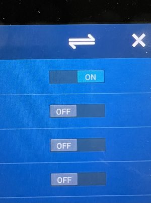

It is most likely that N2K problems would effect the first TZT to fully boot up and assume the role on handling NMEA 2000 communications. In the PGN output menu, you can see an opposing arrow symbol in the top right of the unit doing this.

Is it possible that the faster boot time on Port sets it as the N2K comms master?
Do you have a pic of the 'opposing arrow symbol' you reference, i'm not tracking what you mean?

Here is a pic of the "opposing arrow" symbol that denotes the "data master" setting. It is indeed base don which unit boots up first. Nothing to do with what power button is pressed first. They all have different boot speeds. It does seem that the chart masters tend to be a bit slower on boot than the rest.

If your NMEA 2000 bus has an issue, the unit with the arrows will be the one doing the communications (Data Master) and will be the first one to not like any bus problem.
