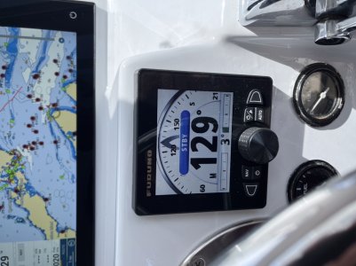

My 711C autopilot is setup and operating correctly and indicate# rudder position corr3ctly on the 711C but I get a “blank” on the TZT rudder indicator.
Photo of 711C and TZT to show the discrepancy. I’ve RTFM for the 711C and can’t find how I verify it is putting the rudder indicator command out onto the NMEA200 network correctly.
Rudder indicator correct on 711C:D4A3F319-F15F-4702-994F-FB3DEADB8800.jpeg

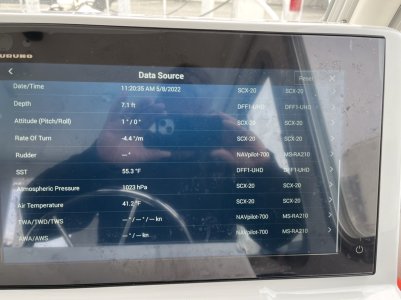

And not showing up in TZT sensor list:

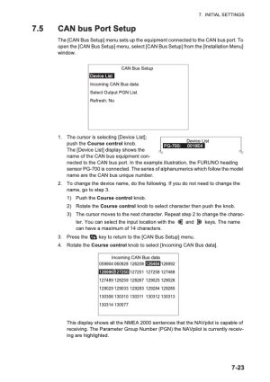

What do you see when you go to the "CANbus setup" page submenu under system setting for "Select Output PGN"? 12745 is the rudder data and should be turned on so the NAVPilot transmit that data over the NMEA 2000 network.
Maybe you should run over to Menemsha. Hope this helps.
NAVPILOT Operator Manual.jpgI found that manual section that describes this setting. The next page describes the output PGN setting, which is what you need to check.

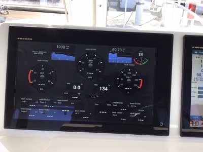

C2A48C52-587F-41B7-AC55-5516DE47A6B1.jpegThank you all very much. Sometimes it’s takes a village!
I clicked my heels 3 times and while I’m not in Kansas, look - I know have my rudder indicator where I want it!!!

Glad it worked out. You know you can customize the warning range for the engine gauges for oil pressure, engine temperature, and so on? Yours don’t look like the red area is right for the Diesel engine.
Go to “Initial Settings”/instrument/Propulsion and you can set the red zones and rpm range to the appropriate values.
