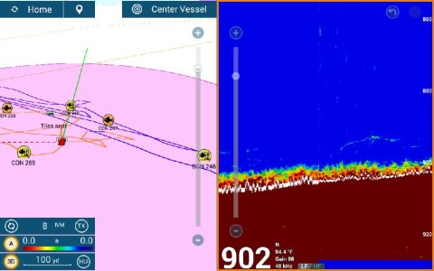

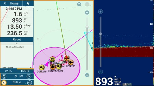

Would anyone be willing to share (or suggest) what preset frequencies I should setup with this xducer using the TZT3 sounder?
Most of my fishing is canyon or inshore trolling with some tile fishing (600-800') of water and some bottom/wreck fishing in < 120' of water.
Also, does anybody have a good primer on CW (Fixed Frequency) vs. FM (Manual Chirp) - when and why to use one or the the other?
